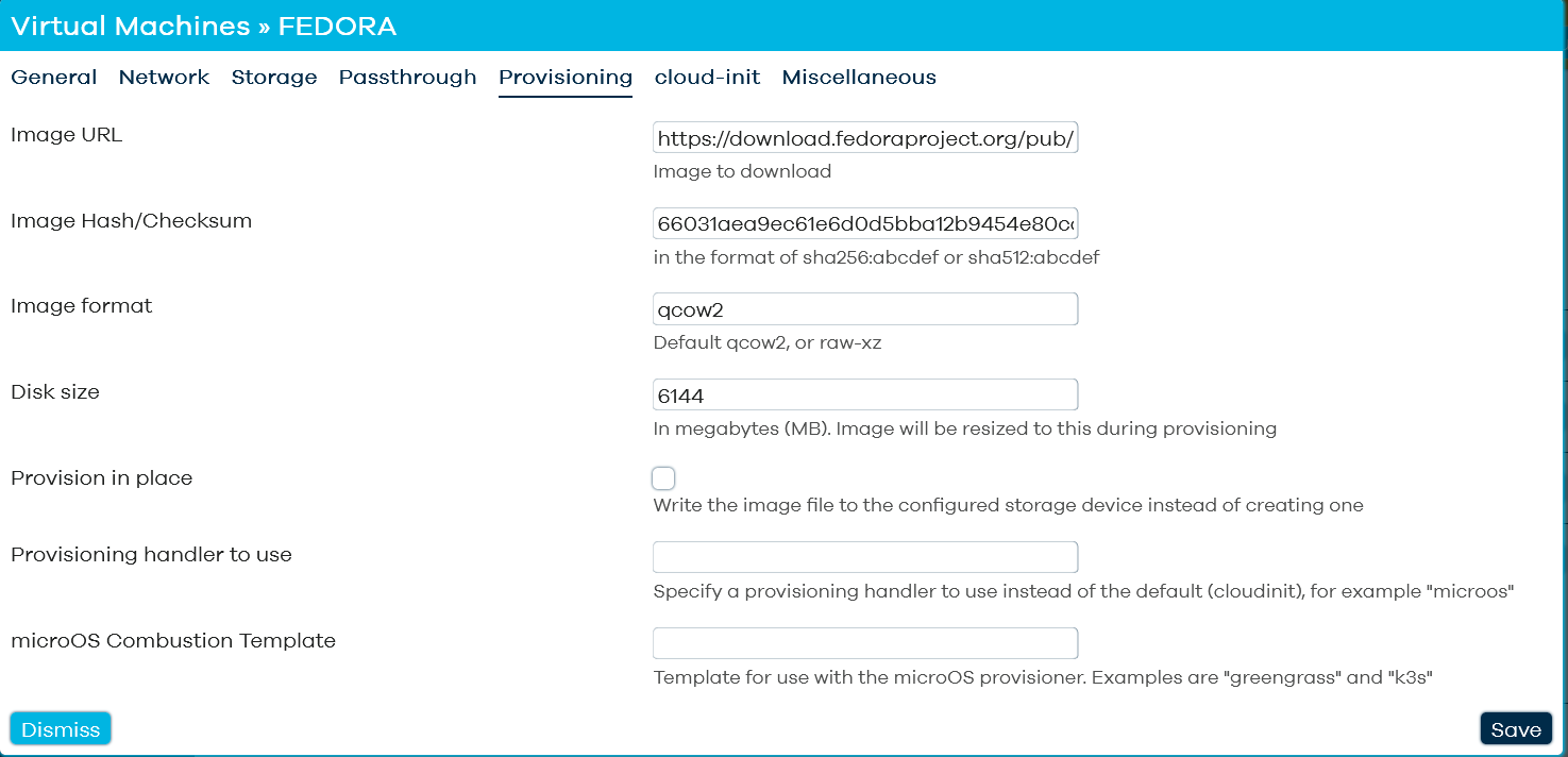

I suspect it’s not creating a big enough volume for the image. The Fedora 43 aarch64 image (qcow2) expands to 5GB so I would make sure the “disk size” setting is 6144MB (6GB) or higher.
The setting is under the “Provisioning” tab:
It looks like the provisioning has already created a volume , so you should remove that one with lvremove /dev/mapper/vmdata-fedora before attempting it again.
Unfortunately, I recently had to remove Fedora from the appliance store lists because some infrastructure changes at Fedora broke my method of finding image data. I will get it fixed soon.
(The appliance/bare metal store lists we publish contain a minimum disk size for each distribution)
If you need to setup a Fedora 43 VM, you can:
  1. Pick another appliance that uses cloud-init (like Ubuntu)
  2. Before starting on the new appliance, go to the provisioning tab and change the image URL to https://download.fedoraproject.org/pub/fedora/linux/releases/43/Cloud/aarch64/images/Fedora-Cloud-Base-Generic-43-1.6.aarch64.qcow2 and Image Hash to sha256:66031aea9ec61e6d0d5bba12b9454e80ca94e8a79c913d37ded4c60311705b8b
The URL is from the Fedora Cloud Download page, so I would re-check the URL and sha256 in case it changes :slight_smile:
