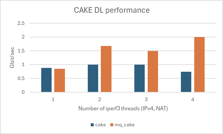

EDIT: Yes, muvirt gives much better SQM throughput in both directions.
So, given the huge difference in SQM throughput, how do we get OpenWRT upstream to have performance as good as the Traverse images?
I tried adding memlimit 32mb to the SQM options on vanilla OpenWRT, but the throughput stays low: around 200 megabits with packet steering disabled, around 600 with it enabled, and around 300 with enabled (all CPUs).
It’s on my list to look at soon (in the next few weeks), I’d like to run the bufferbloat test suite (flent) between the stock OpenWrt and our change (the memory patch) to confirm this.
I think the patch will need to be reworked to allow the buffer size to be selectable at kernel compile time (via a KConfig setting) so it can be implemented per-target/arch in OpenWrt.
It’s been a while, are there any new updates about the SQM performance difference?
I’ve found another performance issue which needs to be solved first. In general, recent OpenWrt releases have poor throughput (WAN->LAN) on the Ten64, much lower than we have previously seen. It has gone undetected as I did not have access to a fast (>1G) test site for a while.
The SQM setup in the kernel (4 vs 64MB buffer) doesn’t appear to be related to this, but the performance regression needs to be fixed first before we can do something about the SQM setup.
I will need to go through each major release (21.02/23.05/24.10 etc.) and see if the regression can be identified. (I think the transition to nftables/fw4 is the most likely regression point)

mq-cake has landed in OpenWrt just recently and the results are promising.
It’s lifted the downlink performance ceiling from 1G/s to 2Gb/s (up to 3Gb/s might be possible with tuning of the flow->CPU distribution)
The caveat is that single-thread DL performance is the same (1 thread = ~880mbps).
These tests are done in a simulated setup (only to see where the bottlenecks are), but I will try testing it with a live connection and test tools sometime soon.
Looks like there’s a known issue of Cake MQ being slower than expected. I’ll keep an eye out for when the fix gets rolled out.
